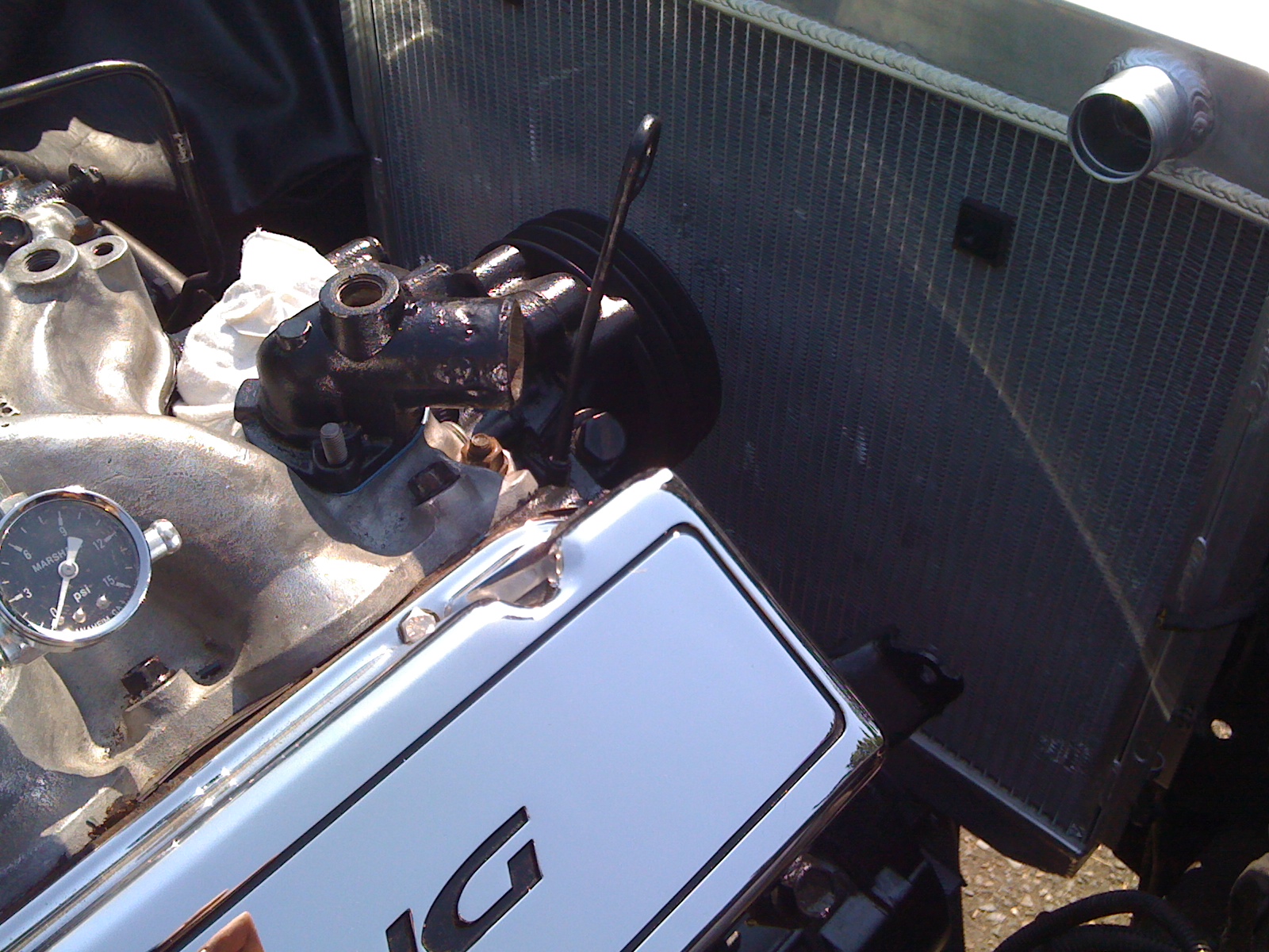

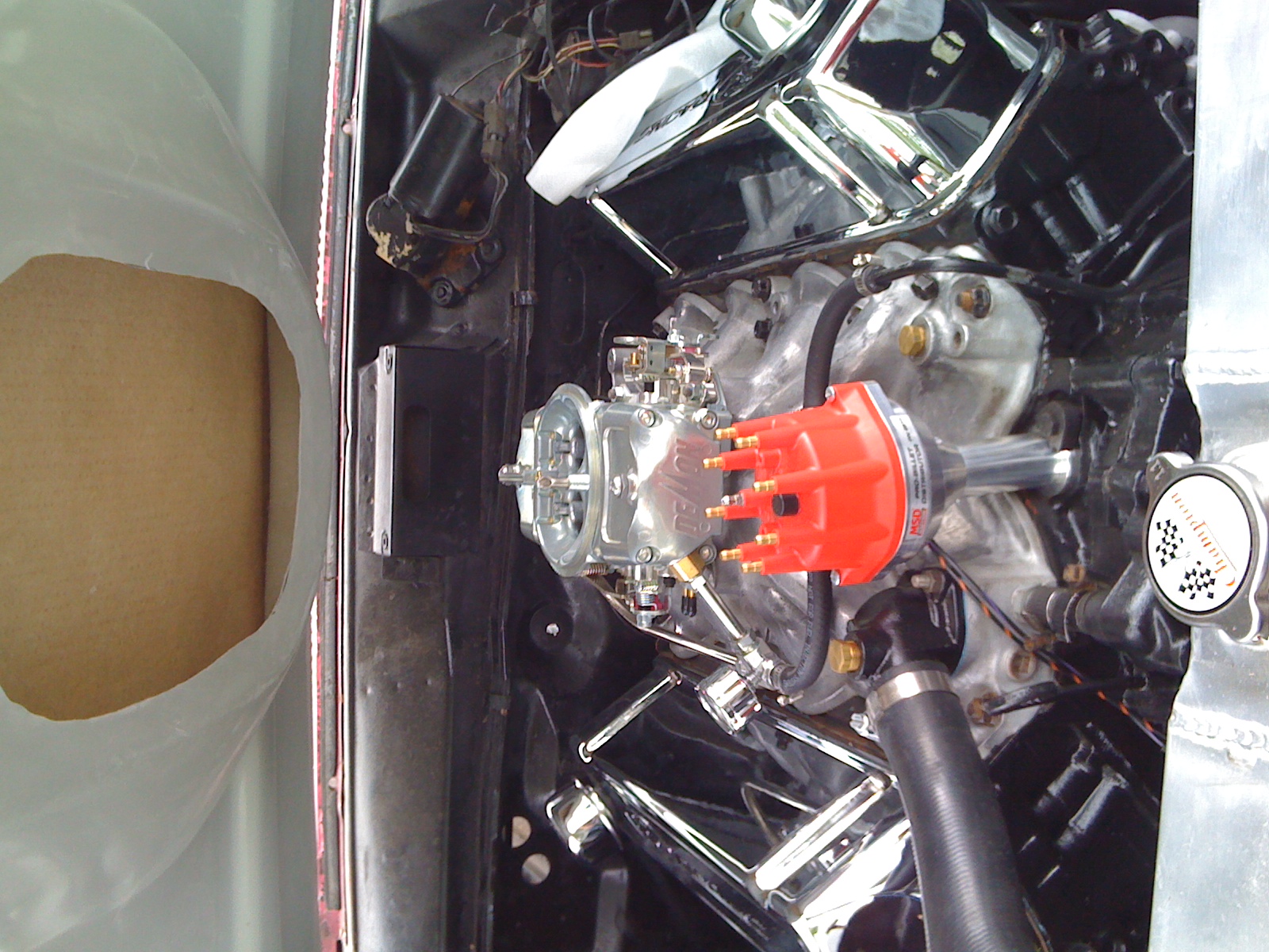

Fits like a charm. I've dropped a 429scj into a 68 fairlane and I have a 460 in my 1966 fairlane.
From what I've heard the difference in weight is around 70lbs. But that's assuming cast just about everything on both motors. Replacing the intake with aluminum just about evens that out.
Here are some pics of my '66 the engine is tight but I've done zero mods to the engine compartment. I'm planning on hacking out the shock towers next time I pull the motor just for the hell of it.

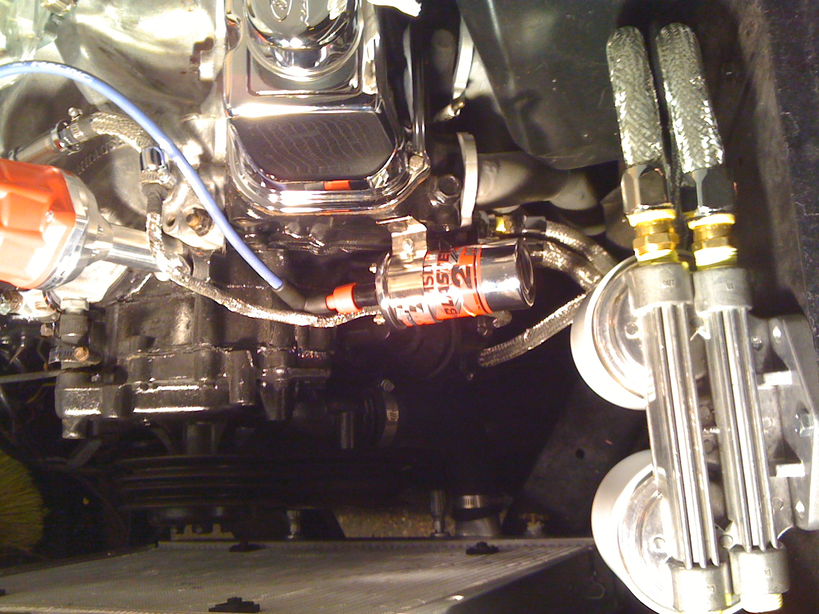

I definitely advise relocation on the oil filter as seen here:

I run a perma cool electric fan set to push. it was too tight of a fit to make it work in a pulling fashion:
The fit looks a lit tighter then it really is, but that's part of what makes the swap badass IMHO:

hey flip curious about motorsport valve covers won`t clear master cyl.on my 66fairlane or was that a pic of your 68 engine bay. Bill
