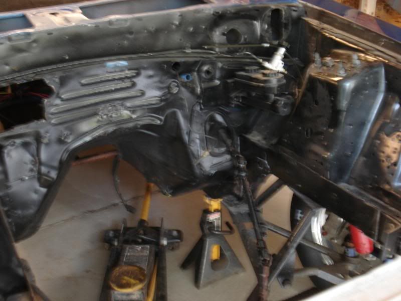

Hello to all. Here is my build. I have an 1989 mustang coupe that I am stuffing a 500 plus ci BBF with a 2 speed power glide in it. Up on top of the motor will be TFS A460 heads and intake. Turning the wheels will be a 8.8 narrowed with 35 spline axles. I'm gonna break everything down into sections motor,trans,chassis etc. Pics will follow at the end. Thx for looking
motor
TFS A460 heads cnc'd 2.45in 1.88 ex
TFS intake new style ported to match heads
IDT ultra block
scat forged crank
eagle h-beam rods forged
crane cam .866in .858ex w/1.65
282 dur in, 304 dur ex.
comp cam solid roller lifters
1.7 jessel shaftmount rockers
jomar 1 inch spacer
quick fuel 1250 dominator
meizer water pump
ford racing valve covers
trend push rods
Danny bee belt drive
transmission
2 speed power glide
ultra bell
JW fly wheel
1.80 str cut gears
pro trans brake
deep aluminum pan
precision converter 4500 stall
chassis
front
1989 mustang coupe
tubular k-member
tubular a-arms
90/10 struts
coil over kit w/150 spring
flaming river must II rack
custom cc plates
4 core griffin radiator
drive shaft safety loop
6 inch harwood hood
rear
mini tubbed
8.8 rear narrowed and braced
moser 35 spline axles
mark william spool and yoke
aluminum rear cover
aero space brakes all 4 corners
Qa1 rear coil over kit single adj
parachute mount
fiberglass trunk
wheels and tires
weld magnum 2 piece rear 15x10 3in back space
M/T et drag 29.5x10.5 stiff on rear
weld magnum 1 piece front 15x3.5 2.25 back space
M/T et front 15x26
Fuel system
magna fuel pro star 500 w/filter
magna fuel 4 port regulator
5 gallon fuel cell
-12 line cell to pump
-10 line pump to regulator
Interior
stock dash gutted
8 panel painless wiring switch panel
detatchable steering wheel
10 pt mild steel cage certed to 2011
hurst shifter
electric shifter
summit ignition box and coil
racing seats
standard gauges
Well I beleive I covered almost every thing. Here are some pics
