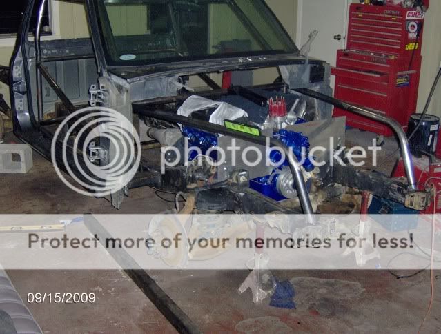

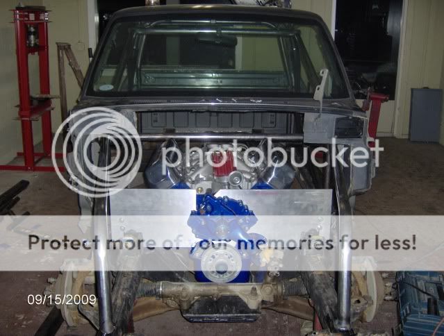

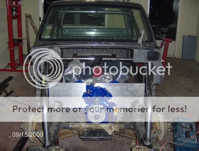

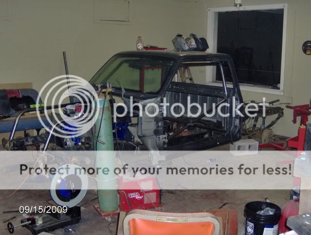

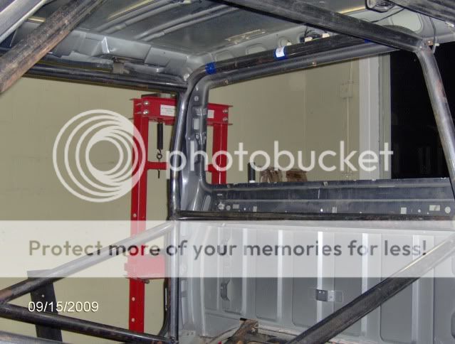

Thanks guys we are working on getting the cage in it got about half of it tacked in place going to get all the bars in before welding them all up leaveing the bars off to the rear until we pull the cab off and get the other bar welded all the way around them and painted leave just wear the rear bar connect to the cage unpainted

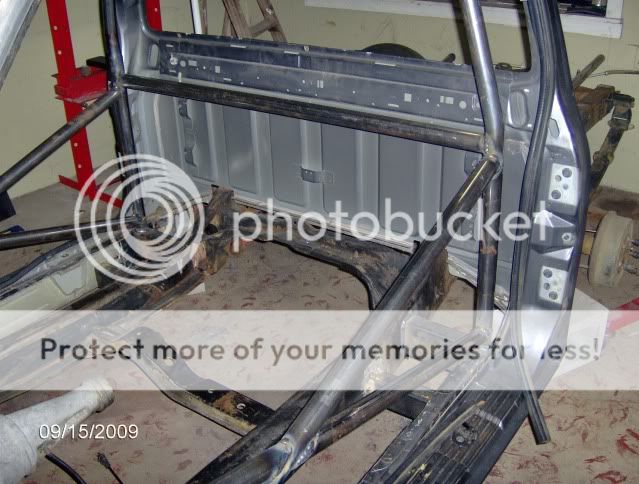

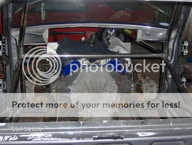

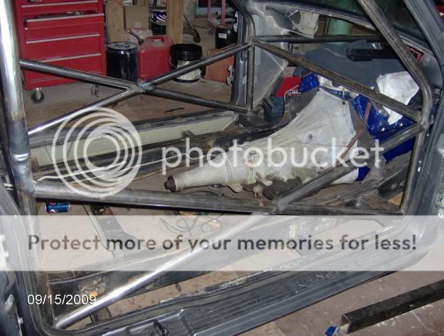

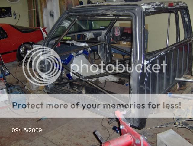

post #40 of 430 (permalink) Old 09-15-2009, 11:05 PM Thread Starter
Forum Contributor
69F100's Avatar
Join Date: Jan 2009
Location: Irwinville Ga.
Posts: 1,398
OK here is some pics of the unfinshed cage still have to weld it all up leaving the rear bars off until we pull the cab off so I can weld all the way aroung the joints so I can make sure they are welded good and get them painted except where the rear bars connect.

post #41 of 430 (permalink) Old 09-16-2009, 06:38 PM
Super Moderator
bigblok86ranger's Avatar
Join Date: Mar 2009
Location: Beloit , Wisconsin
Posts: 5,255
Quoted: 13 Post(s)
Send a message via Yahoo to bigblok86ranger
Looks great , was the cage prenotched or did you have to do it all yourself ? I am sure there was some trimming but , I wonder if it was closer than my jegs kit I used in my 86 .
bigblok86ranger is offline
post #42 of 430 (permalink) Old 09-16-2009, 06:55 PM Thread Starter
Forum Contributor
69F100's Avatar
Join Date: Jan 2009
Posts: 1,398
Yes it was notched on one end but when I told him what I was going to do he made the bars alittle longer so I could costume fit them the way I wanted them but it turned out they could have been shorter with me lowering the cab. I have no complates on them and they are very affordable and answered all my ?s I had and he told me how he was going to do them

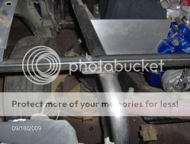

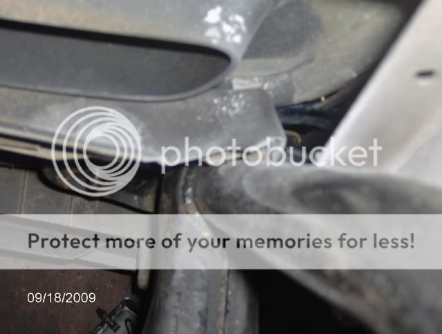

post #43 of 430 (permalink) Old 09-19-2009, 06:17 AM Thread Starter
Forum Contributor
69F100's Avatar
Join Date: Jan 2009
Posts: 1,398

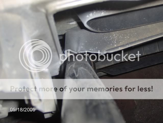

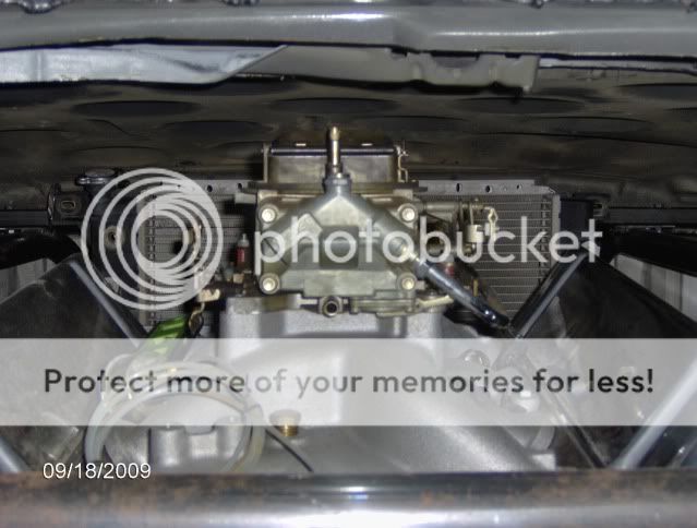

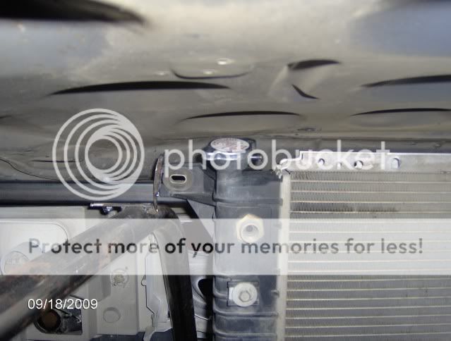

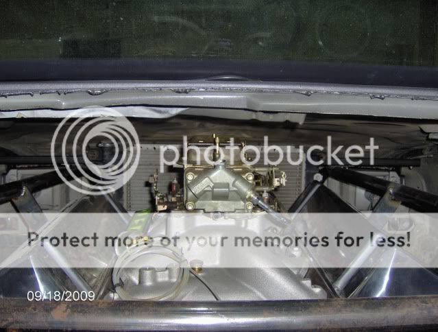

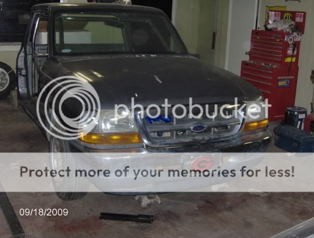

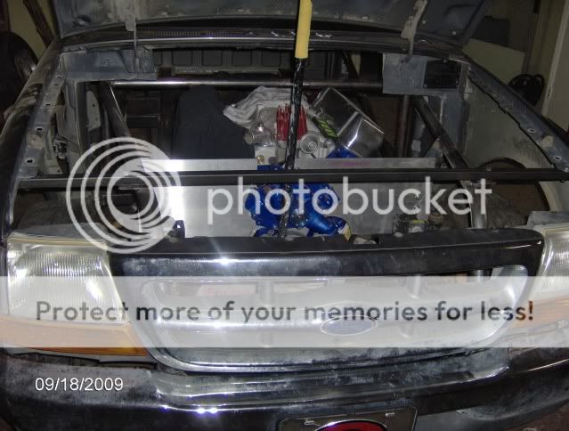

Got the front end bolted back I had to notch the grill alittle on the back side for it to fit around the front bars it would have been fine if I hadn't lowered the cab.The front bumper was the hardest had to drop the brackets the hold the bumper on, getting them lined up and getting it tack for I could weld it.I can have the front clip off in less than 5 mins.4 hood bolts, 8 fender bolts and 4 bumper bolts and set it off. The bumper the way I got it set up it don't have to come off to take the fenders and grill off the truck.It only takes a 5/16 ,two 1/2s for the fenders and grill, 17mm for bumper.On the carb I can run a 1" spacer if I need to with a 1" spacer I will have only 1/2" to 3/4" to the hood clearance, rad has about 1" clearance on it.Heres some pics.

post #45 of 430 (permalink) Old 09-19-2009, 10:47 AM
billandlori's Avatar
Join Date: Sep 2006
Location: Stratford, Ontario Canada
Posts: 2,013
Lookin good!! All that engine setback is really helping you out with carb clearance.
