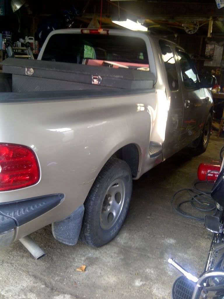

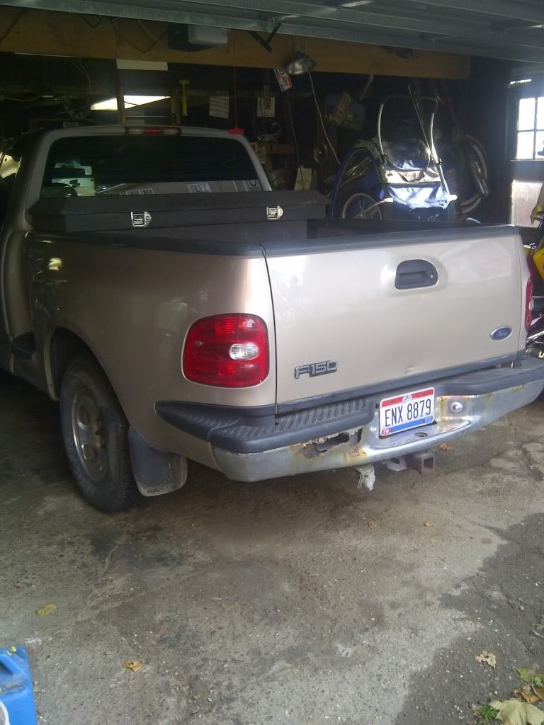

Well I have finally got some time to post some of my progress on my build, I have taken a few pics along the way as this is my first real "build" of this kind. I am learning a lot hope to get this thing done before Febuary. I am going to spend the next couple of days loading in my pics and explaining what I have done. Please feel free to offer suggestions.
Here are some pics of the truck and the bodywork that needed done first.
Small Garage but it will work
I didn't take a pickof it but as with most Ford f150s of this era, both rocker panels were shot

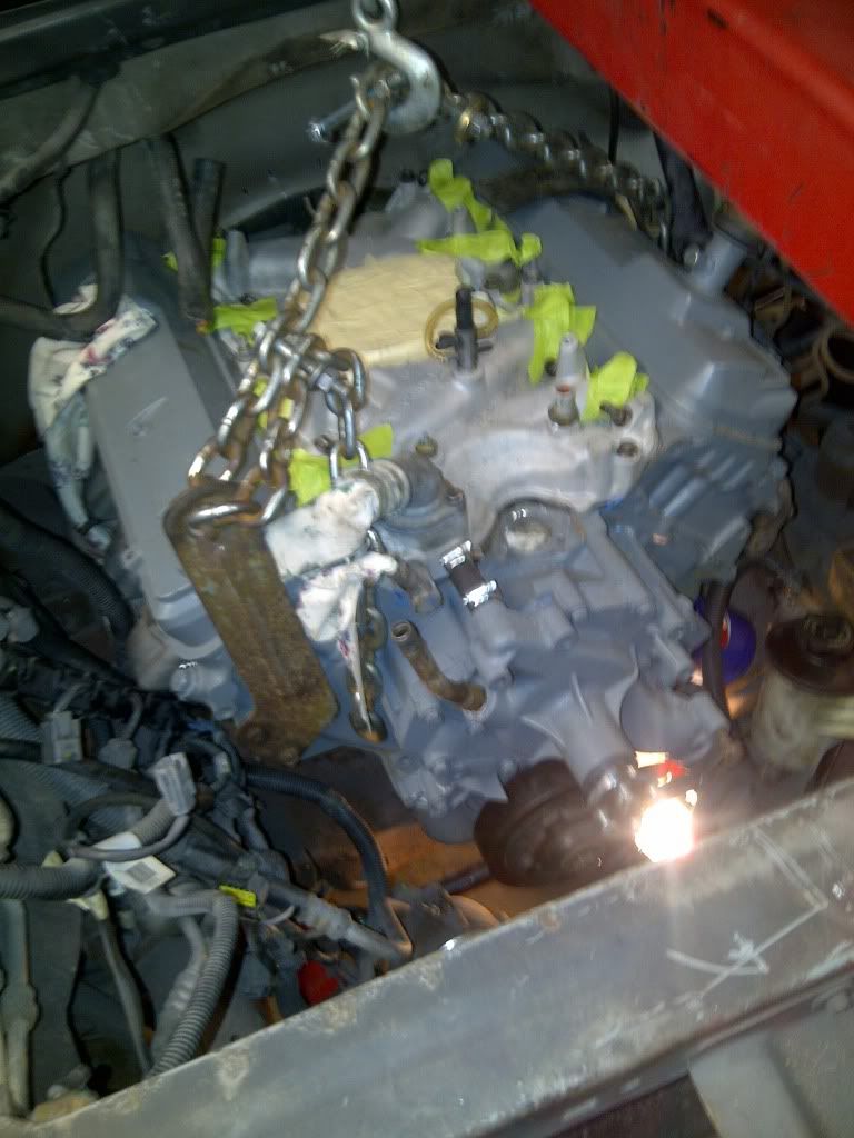

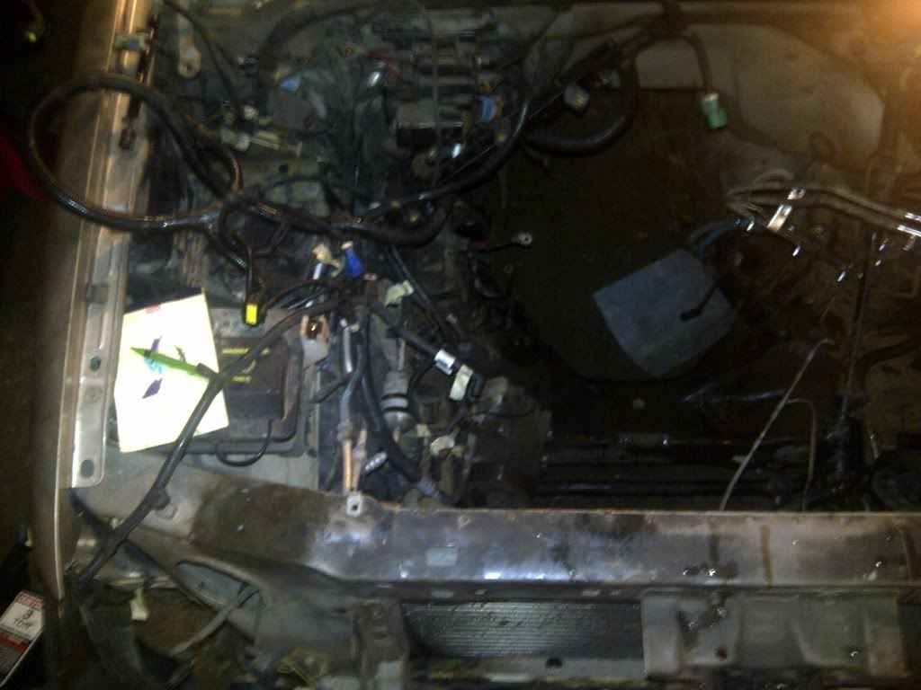

Before I got into the bodywork, I wanted to get the engine out to see what I was working with and take some measurements.
The old wire harness takes up a lot of room but I decided to work around it until I start in on the electrical ( a long time from now) and install the 460 ecu as I want to do that together. I know I am going to need to keep some of that harness and ecu to run a few things. I do not what to get ahead of myself with the wiring

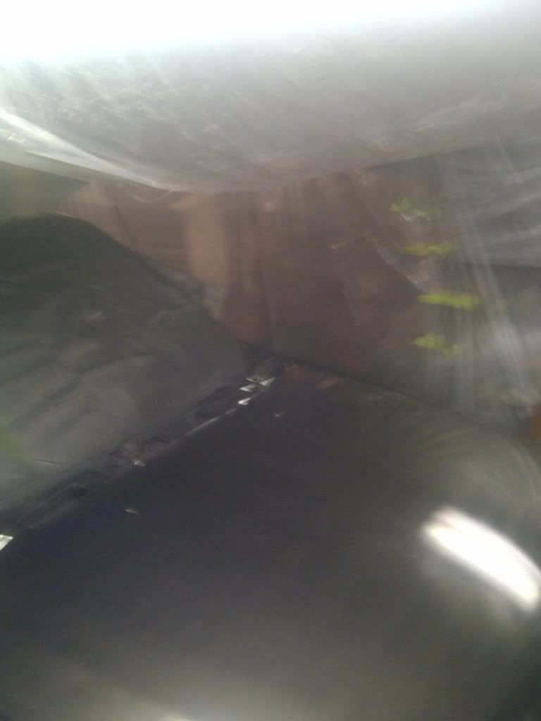

The following pics are of my bodywork and new paint. I wanted to spend more time on it but it was the end of September in Ohio and I knew I was running out of good Ohio weather. I can not wait until spring because my wife and I are going to have our second child at the end of Febuary so this has to be done! The only source of heat in my garage is a nice woodburner but woodburners and a sprayed paint do not mix! As with most things on this build, I have done some bodywork and some painting before, but this is the first whole car for me. I am glad I get to practice on an old truck.

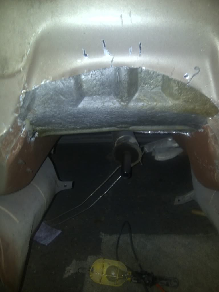

This is pre paint - I took the car out and cleaned it a final time. I rebuilt the rockers and cab corner with fiberglass. It was cheaper than replacement steel and will not rust again!
Not a good pic but this is the best I got after the seal, color and clear was applied. Notice the striping on the hood, it wierdly is not as visable in person but you can tell that I am an beginner painter. I overlaped 50% like you are supposed to but research I have done indicated that I didnt have the correct airpressure. The rest of the truck does not have this so when I do this again on another car, I am going to take the hood off and paint it vertically.
It only cost about 25$ to turn my garage into a booth. I simply puchased 1 mill plastic and stapled it up, then I purchased a furnace filter that I placed on one end of the garage and placed a fan on the other end facing the open mandoor. I did learn one important lesson from this. Cleacoat does not play well with fans. I was in the middle of painting; I blinked and noticed my eyelashes kind of stuck together! I then noticed that I could not see my workbench. I realized my fan locked up. Long story short, I owe my daughter a new fan as I had to steal hers!

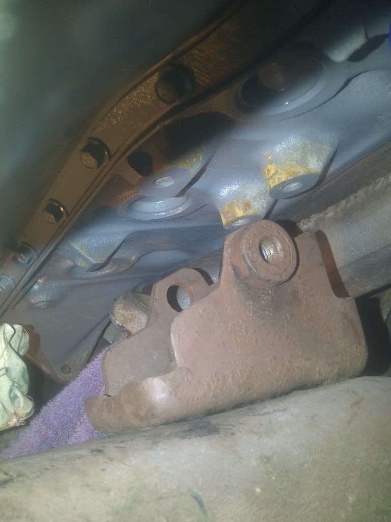

This is a rough cut hole I had to make in the firewall. My e40d did not sit far enough back. I only needed about an inch and the BFH wasn't enough. As soon as the measurements taken for my motor mounts and trans brace I am going to clean that up and make a plate for it.
Not the best pic. I have to get it placed exactly where I want it yet before taking measurements.
I was suprised that the motormounts came this close! This is a pick of the dr side stand off. I took the standoffs out but now I think I might be able to use them with some modification. I am thinking maybe a flat peace of steal on the motor holding a piece of sqaure bar (reinfoced on the sides by plate steel) with tude steal holding a polyurethaine bushing that bolts into the standoff. If I do this, I might need to reinforce the standoff. Any thoughts?

I'd turn the standoff around so you could put the bolt in from the front.

The only problem with that is that standoff is bolted by 3 bold that wouldn't line up. I can get to it okay from the back - I could to that on the other side more easily

Sat the motor down on a block of wood in the truck. That gave me the oportunity to clearence the throttle body. WOW, I didnt realize how tall that thing was. I needed 10 1/4" and only had 9" under the wiper box.
Well the good news is that is fits now! The bad news is I can't drive in the rain! Actually I can fit some spacers in and raise the wiper assembly enough to make it work. Checked that before I did any cutting. I am going to need to do a little more cutting to make this all work but it at least sits in there.
