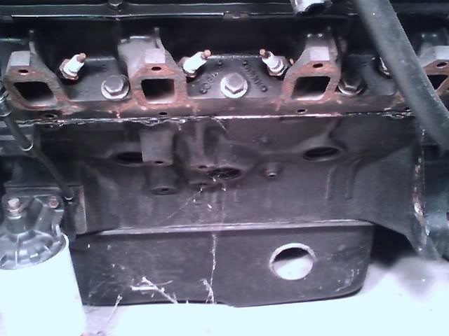

The ford pan I have on mine had the following part number(s) stamped on it: (#4 0489A) E7HE 6675. This is the best pic I have to show it's shape, holds about 10 liters.
found this one also:
77F150 is offline

Danny,77f-150,thats exactly what i was looking for ,thanks guys.
77f150 is that the stock pan for your truck?I may look for a good used one , i still have to modify it to put it on the mustang. Or i might save the hassel and just get a new one then modify . thanks again........Ron

It's a pan that came off a Ford dump truck. The long block had it on when I bought it years ago.
