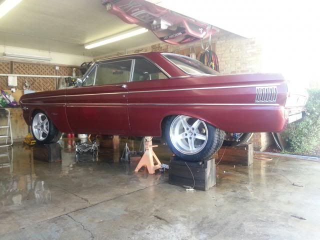

Being on a budget I just built some blocks to get my car up off the ground. Then after that use safety glasses and a face shield because crap goes everywhere. I like to use a 4 1/2" grinder with a wire wheel and go to town. Don't forget gloves, a long sleeve shirt, a hat and probably some ear plugs. . Also use a grinder with a momentary switch NOT one with an on/off switch. If it should get out of your hands you want it to shut off ASAP. As far as painting you just have to go slower than you could on a vertical surface but it will work fine overhead.
