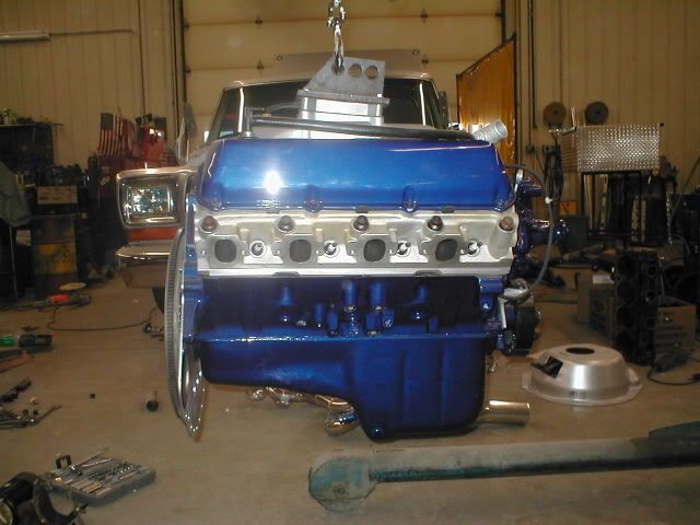

I don't know what you are planning paintwise. I painted mine with the same paint as the outside of my truck. I had problems the last time I painted it with the high build surfacer that separated apart looking like this
This time I skipped the surfacer and went directly over velvetseal. Hopefully it will stay this time (don't know for sure):lol:

From the looks of your pictures you might have gotten the paint a little too thick causing it too peal. If you are spraying conventional automotive paint directly over bare metal It might now stick very well.

I used a product called urofill. It is a really high build urethane surfacer that I sprayed on to smooth out all the grinder marks. That is what separated because when you knocked off the loose chips, the urofill would be stuck to the back of the blue and still be on the block also. That is why I eliminated that step this time. I figured it would still look okay without it after that happened, so I stripped it all and repainted it to peoples suggestions. Use a good etching primer and spray your color straight over that.
