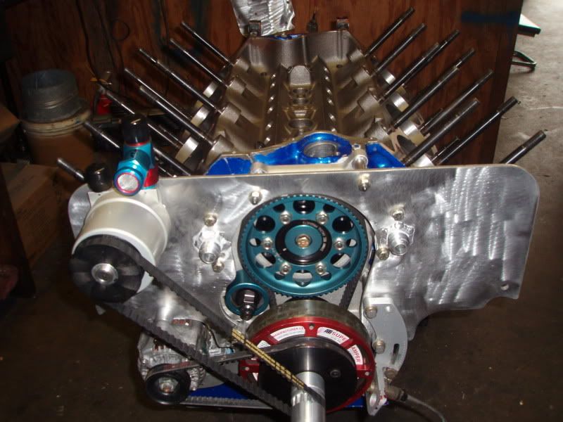

On tuesday we dyno Snowball's motor, It made 1155hp at 7200rpm and 920tq at 6100rpm. They are going to run it this weekend and see how it compared to the other 606ci C headed motor.

Anyway, the phone call I got was from Robert Snowball and he said they made 1146 Hp,,,,,so the 1155 Hp number is small potatos,,,,, Maybe they made another pull after I got the call. The engine has a single Dominator style carb on a C-460 intake manifold and I'm pretty sure that it's on gasoline. It has a new set of my CNC ported C-460 heads with Victory 1 titanium valves, and PSI #1249 springs. Those are some extra good numbers out of a single 4 deal, and Robert has every reason to be proud. He told me he was "stoked" and couldn't wait to go racing!

If he wants to post detail's he will. Charlie might be right about the 1146. I remember see 1155hp on the last pull and the one before that was 1153hp.
Here is a crappy video. From my phone
http://pictures.sprintpcs.com/share....tate=RETRIEVED
Here is a picture

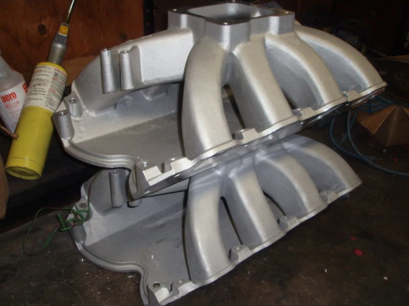

Here are the intakes. We are putting another one togther also. Waiting on the heads from Charlie.

Honestly, Craig Sullivan mastered this combination.
I used a ultra eliminator block
Bryant 4.500
Carillo 6.800 rods
JE pistons
LSM swap cam .910 int 287 @.050
.890 ex 308 @ .050
Charlie's CNC C heads Victory valves PSI springs
Crower Hippo's lifters
16.09 to 1 run on c-16
4.615 bore
4.500 stroke
pistons .015 in hole
.045 cometic
4.6 cc dome
It made a best of 1157, and 921 ft lbs. Made over 1100 from 6500 on up to 7300, and started to fall off. We made about 10 pulls. Max timing it liked was 32 degrees. This is on a dyno we affectionantly call the heartbreaker because it don't give you anything you don't deserve.
Bob Book carburetor made a tad more torque, but my pro Systems carb was way more consistent thru out the pulls. Both made basically same power.
I believe this combo is badass, and I think Charlie's CNC program is quite a bit better than the hand ported heads I have on another motor. Whats really wild is the intake is untouched except where Craig laid back the fins that hang out under the carburetor at front and rear of intake. I will try it against a really untouched intake on the other motor I'm doing for my partner.
