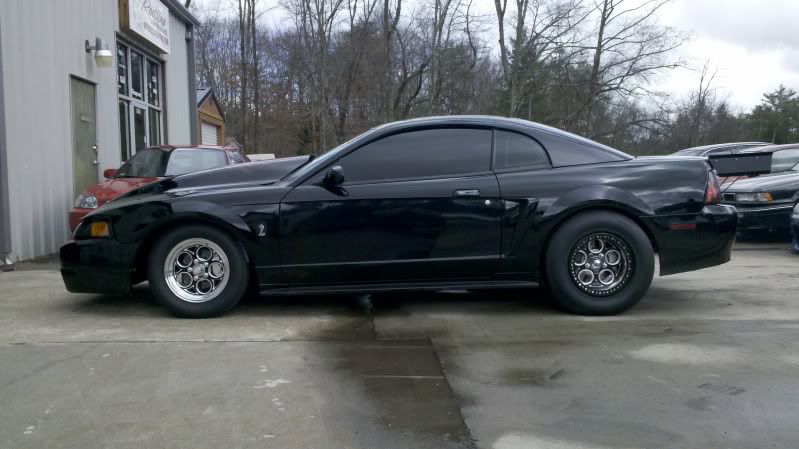

So here is the engine build:
Srp Flat top piston 4.390
CAT forged h beam rods
stock crank
KIng Bearing cam and crank
procomp electric water pump
stealth intake out of the box
Police heads
crower roller rockers
lunati 61605 cam and lifters
holly 750 dp with percy adjustajets
95 mustang alternator
msd 6al2 box
tremec t56 6 speed with quicktime bellhousing
ford king cobra clutch
stock tremec shifter
stock drive shaft shortened
3.73 gears in a 8.8 rear with 31 spline axles
mt drag radials 275 50 15
3430 with me in the car
fastest pass so far was 11.90 at 118.49 1.69 sixty foot

Cool build, got any pics? Been considering a new edge 460 build myself. What did you use for a swap kit? Any major issues?

used a granatelli kmember, homemade spacers to drop the kmember down, pair of midlegth fox headers, it really isnt a bad fit whatsoever, oh and a canton pan
keep an eye out for used stuff on here and the bay! dont need to spend a ton to make all this work.
the fastest pass so far was 11.90 but that was only MY 6TH EVER PASS on the track...with the et it is a low 11 second car, and with a little tuning may hit 10's
nothing high end about the build, buti learned alot on the way!

with mine i used the Aje k member with upper and lowers and the trans mount from AJE it is a universal mount the only trans it dont fit is a gm 4l80e the k member has universal mounts also so with there k-member you can put just about any motor in it my k-member i didnt have to use spacers for it like you do on most i used the hooker super comp 460 swap headers hear is a pic of the car .

To the OP: is the car full interior and what is your weight? Trying to figure out how much heavier these are than a fox body.

mine is full interror my weight is 3380
