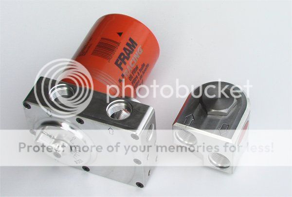

Does anyone know of a 90 deg oil adapter that is similar to moroso's 23682 but accepts -12 fittings?

Just take the oil filter screw on bung out the block, and simply attach your AN fitting right to the block. Get a 90 or 45 thats 3/4NPT to 12AN.

Just wanted to contribute and share this with you guys! I finally found an oil cooler adapter with -12 lines for my turbo bbf. Its a bit pricey but its spoken highly of on the ac cobra and factory five forums and the cutomer service and quality of the part is awesome.
