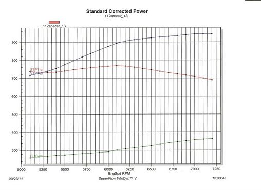

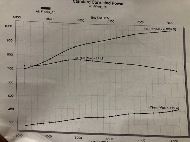

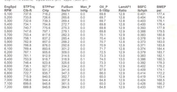

Here's what we ended up with:
Lightly ported TR:
Fully ported TR:
Cly A/F's lightly ported intake:
Cly A/F's fully ported and worked floor:

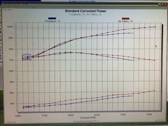

Here's an overlay of the single 4 and the new TR setup:
All else being equal the GZ vac pump was worth about 30 hp.

Here's an overlay from the single 4 with the Crower cam that was originally ground in 2000. It had a regrind some years later that changed the specs -
Old Crower cam - On dyno in 2011 - Red color .
regrind on cam from Cam Doctor: 281/286 @ .050 & 201/206 at .200" installed 4* advanced IO @ 30* ground on a 113 lobe sep
Lobe lift .436- .438 with 1.8 rocker
New Comp cam- Blue color - On dyno in March of 2021
275/277 @.050 & 196/186 @ .200" IC @ 26* ground on a 113* lobe sep
Lobe lift .455-.421 with a 1.8 rocker.
