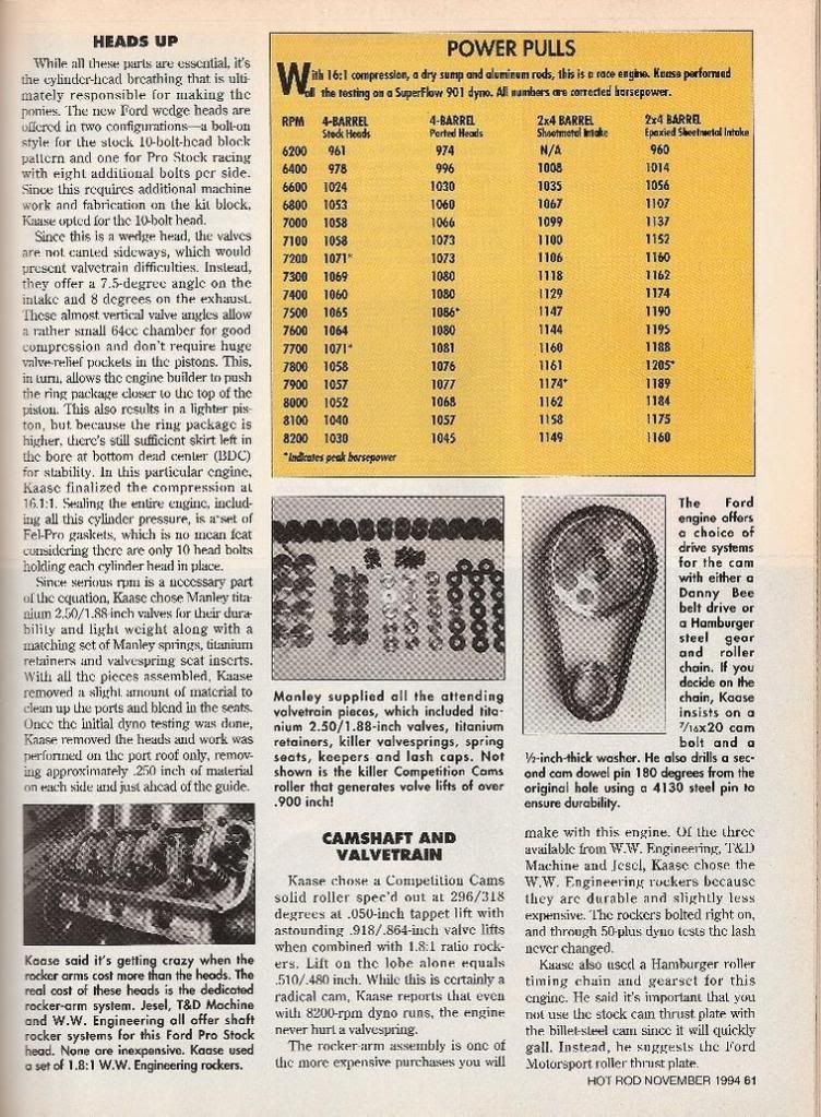

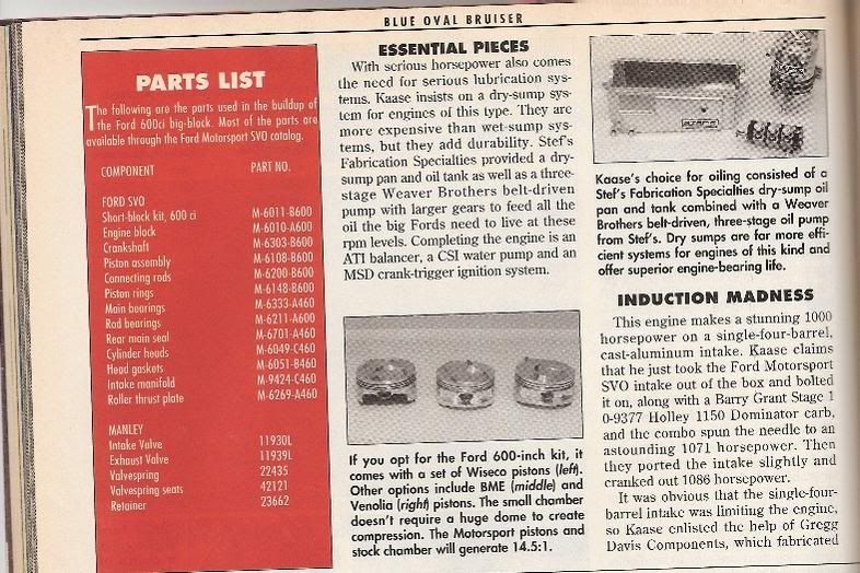

Thank you.....GREAT read!http://www.429-460.com/proven-builds-f4/cylinder-head-info-gathered-by-djohagin-t122-15.htm
Go down towards the bottom and you'll see a lot of good info on C460's on a 4.44 bore.![]()
