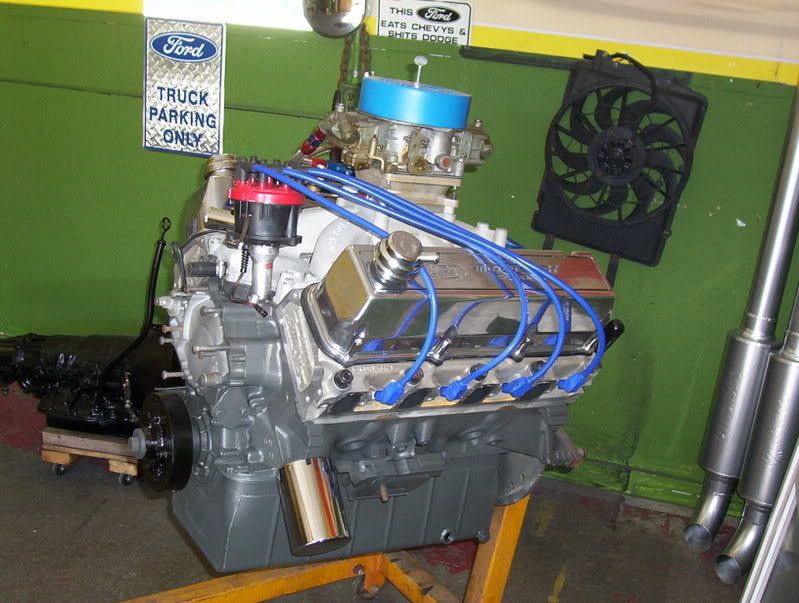

Here's the combo that I ran in my 514 that I had in my boat, I estimated it at around the 600 horse mark.....MONSTER amount of power!......
D1 A2B block, lifter bores bushed, .080" over. Block all debured, no High Flow Dynamics oil mods (didn't know about them yet)
Max ported D0VE-C heads, 52CC chamber (11.2 CR), 2.225" Pro Flo stainless intakes, 1.76" Pro Flo stainless exhaust, hard exhaust seats, bronze guides, Comp ultra-lite roller lifters, Comp dual roller with damper springs (somewhere around 225 closed and 400 open), titanium retainers and 10* locks.
Harland sharp 1.8 roller rockers.
Crower solid roller cam, gross lift: .664" I , .668" E, 248*I, 284*E @ .050", LSA: 108*, installed straight up.
3/8" Comp push rods
Danny Bee belt drive.
Milodon rear sump pan. Stock Mellings HV rear sump pump.
Milodon crank scraper.
Forged flat top pistons.
2Y stock cast crank, off-set ground.
6.7" Eagle H-beam rods.
Weiand tunnel ram (heavily port modified) with dual 750 Holley 4150, 4 corner idle, double pumpers.
MSD 6AL box and MSD small cap dist.
Like I said, this engine put out monstrous amounts of poop and was actually too much motor for the boat, but it was a good combo. Hope that helps.
