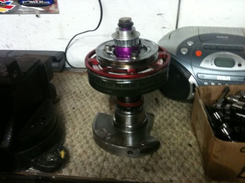

bomb is right, saw one last year break 2 cranks before it was fig out, poor guy
well what was the problem?...solution?
OH, who's was it. I'll talk to them and see how they narrowed it down to the balancer.
Dang Lem, here is another ATI. Must be the only two in the world bolted to the end of a crankshaft. Upon closer observation, this may be a Rattler, I'll find out.
Bad things happen to good persons/parts.
True Lem. Upon verification, yes my pic is a TCI Rattler. He (the owner) doesn't believe it was the fault of the balancer though. huh?
It's coming together.....both these deals may belong to the same owner.
