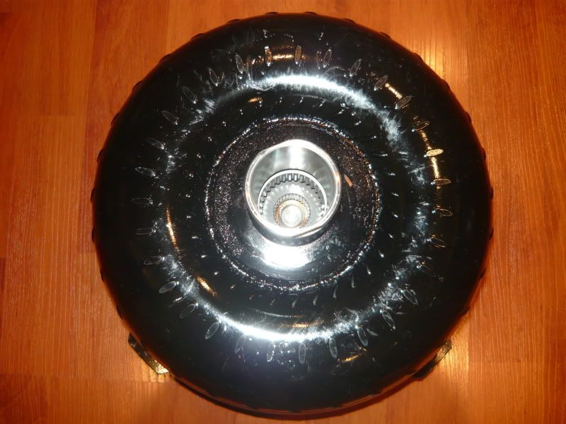

I got home today and had a parcel waiting, 35lbs of beautiful converter:

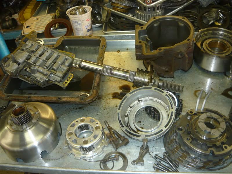

Made a quick trip to the transmission shop, if you call 3hrs each way quick. Took a shot of the guts of the transmisiion laying on the table. The pan looks like it has graphite in it from the ground metal, everything is gouged and you can see metal deposits everywhere. I killed it :eek:
Well the journey is almost over. The transmission has been completely rebuilt with the help of lots of new parts and a core donor. A big "Thanks" to Frank and others who contributed to putting together a list of what to do for rebuilding. Now just need time in the shop for the install and fill her with type F and see the difference. The shop recommended giving it about 100kms before beating the crap out of it to allow everything to work in. Might be tough as it's soon time for storage :).
