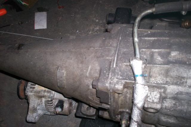

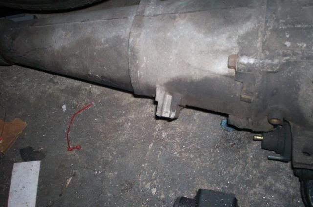

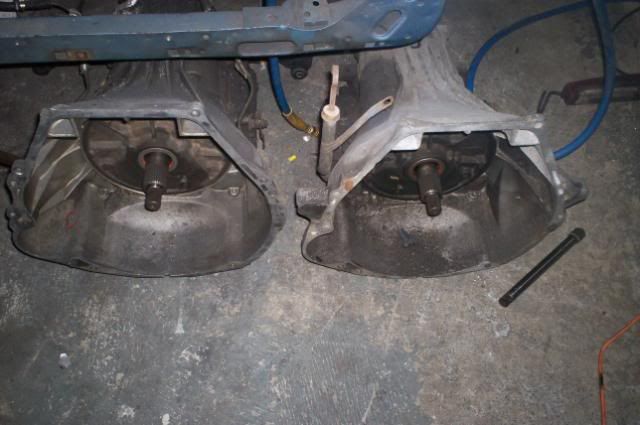

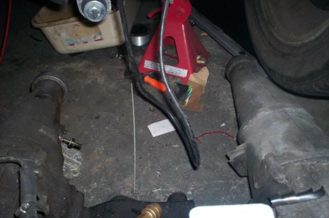

I have two different C-6 tranmissions sitting here. One seem to have a longer extension housing, and the odd side mount setup.
Ill post some pics of both tranmission's
transmissions
tails
tail one
tail 2
i just too make sure i can swap internal's and output shaft's and housings

The trans with the oddball mount is a Lincoln trans (long tail shaft ) don't use it ,but it will be a good parts trans, it will probably have some good parts in it ,ie 5 clutch high/reverse drum
Frank
