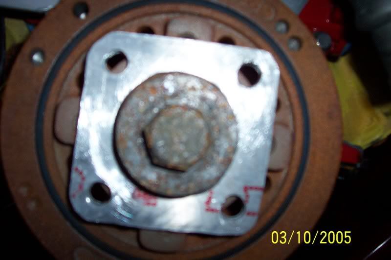

I made a spacer that went behind the crank pulley. If the motor plate is 1/4" thick, the crank pulley spacer needs to be 1/4" thick. Of course, you'll need to space your accessories correctly too.
