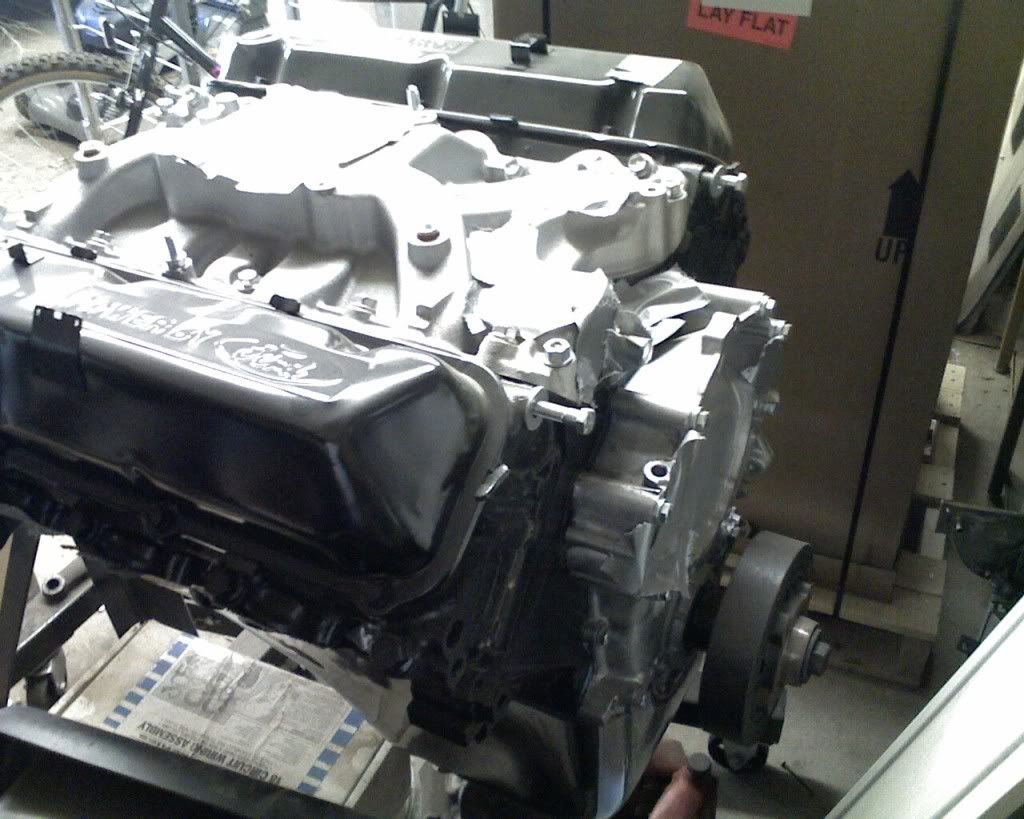

dad bought a 07 c6 a few months back, shortly after i got a bone stock 90 GT. then came those words "wana race". i told him "give me one year".well, the start of my new, huge, limitless money pit as takin off. got my motor and trans yesterday. motor looks great. looks like a fresh rebuild. i got it from a friend whos dad was building it so not sure yet on how much machine work, pistons, rods, crank. pistons look new from outside and theres some work done to heads. goin with edelbrock RPM heads and intake though. if every thing is in as good a shape as i think ill put it in as is, and go from there. so an engine stand, motor mounts, dizzy, ign sys, carb and headers are next on my list. then drive shaft, axles, gears and dif. then heads and intake and..and.. cant wait to get started. heres some pics of what i got so for..

did a partial tear down the other day to see what i need or dont need. gonna scrap the heads and intake, and use edelbrock performer rpm intake, and rpm heads. has a comp cams magnum 292 cam. heres some more pics, ill have more soon.
