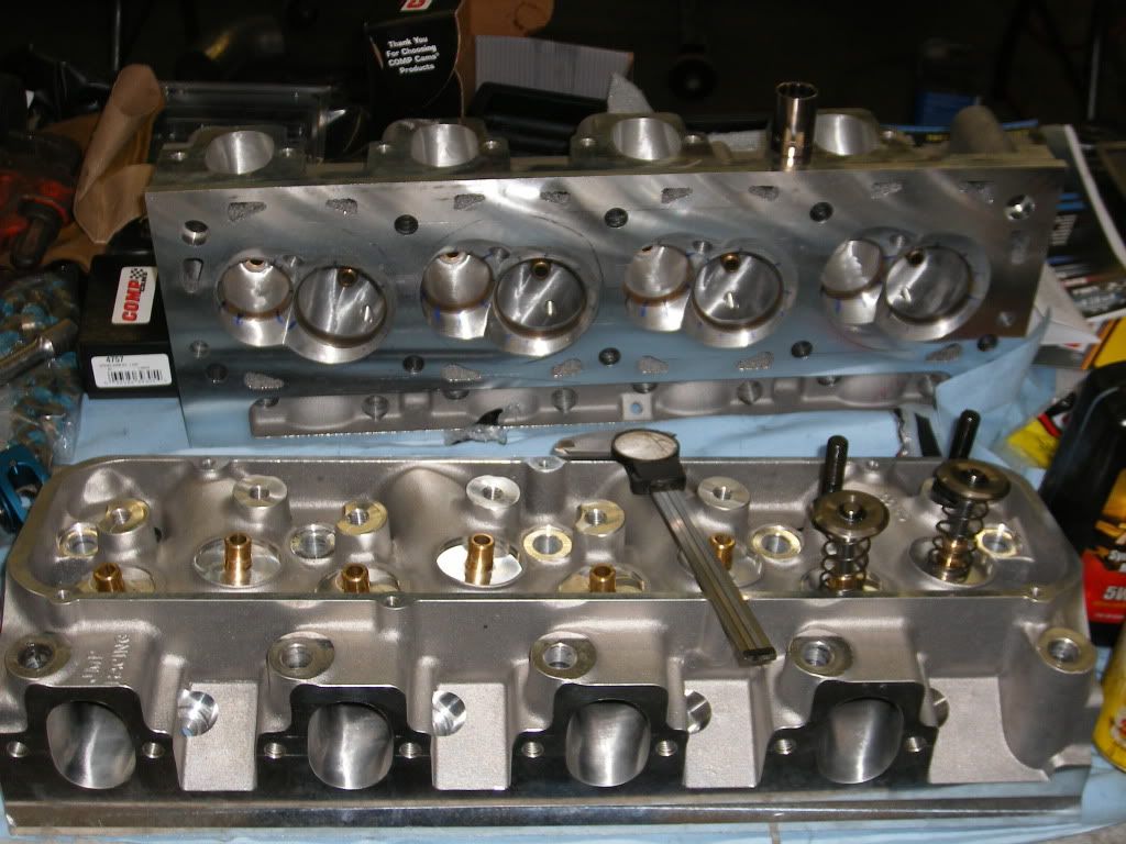

They are really nice heads for the price. I got them a few months ago and here are some pictures I took:
I got the Double D version.........;):D

also thanks pfsracer for the pics it makes the hair on m y neck stand up
That rocker system looks like a sweet set up!
