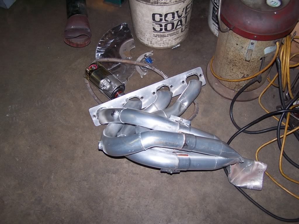

The flywheel came apart, blew through the block slicing the starter in half. It then went through the wall into the next room hitting a metal cabinet.
Went through the wall
Into next room hitting metal cabinet.

Man,that is bad luck and good luck wrapped in one.Bad that it came apart good no one got hurt.Good example why to use the sfi stuff. Hope kaase didn't want the headers back.Were you using arp flywheel bolts or stock ones?Looks like the bolts give up first.

I totally agree that the horse power #'s are great and congrats on that. I think you could repair the block tho.Weld the bolt ears up and redrill and tap them.Or did it do other damage we can't see?Bolts only hold it together dowels should hold the twisting.

We thought about rewelding the mounting points. There is a crack up near the manifold also and a crack near one of the dowels. With this much horsepower it would probably be better to find a new block. It's kind of like blowing up a grenade at the back of the engine. How much stress is there we don't see?
