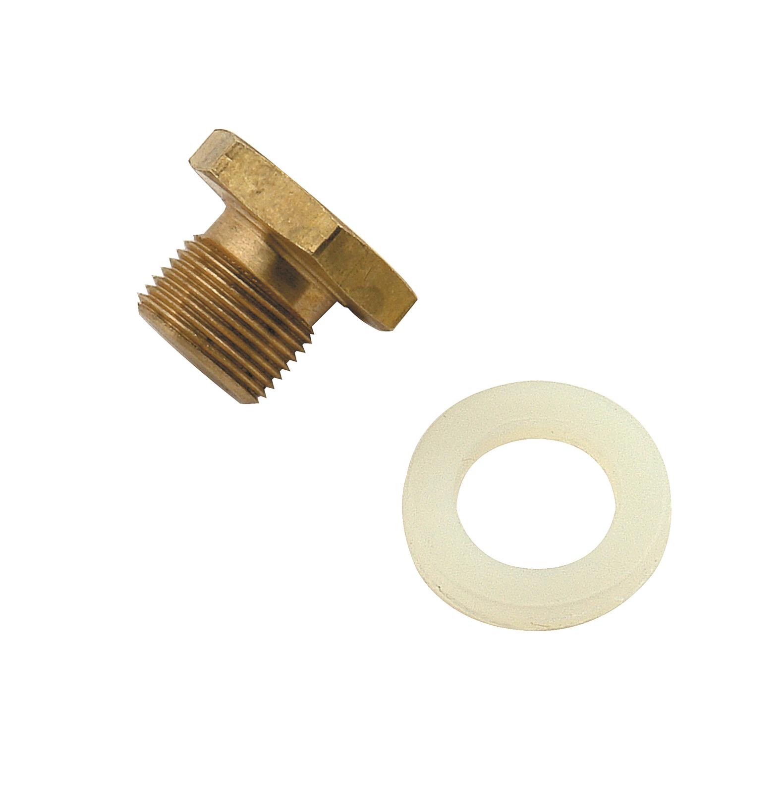

as per the back fire.. if you still have the Holley carb.. they don't like back fires.. it tends to blow out the power valve.. and can cause flooding. watch down the carb when you shut it off for a minute .. watch for smoke .. smoke would be raw fuel running into the carb from a blown power valve. since this is a race application they can be removed and a block off bolt added in its place.. from a kit.
good luck take care be safe
tim
HI Here is a link to power valve and a block off kit. not sure if it fits your application just for reference.
