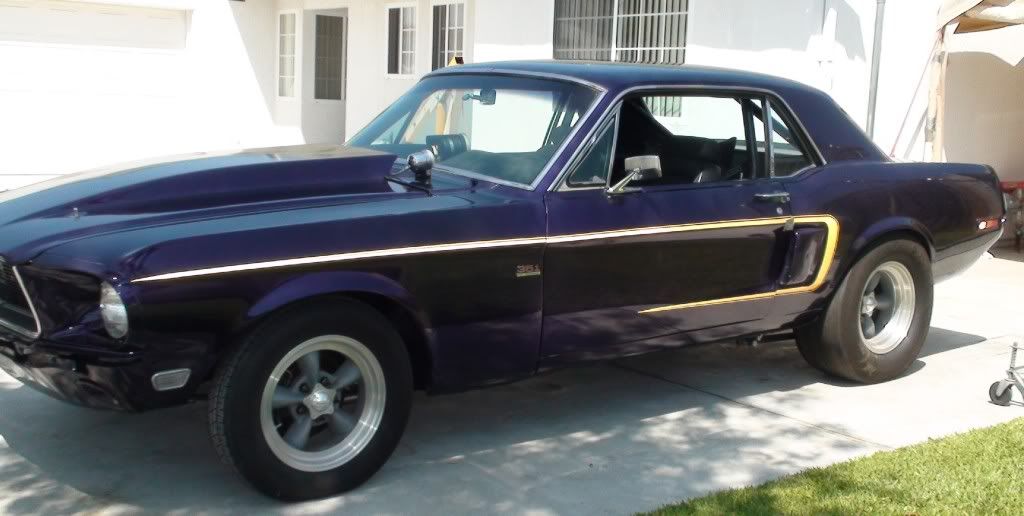

well its up and running finally.still have some things to finish on the car before test and tune.engine build is a .060 over early a460 block,custom flat top pistons,boss "S" rods,crower 4.15 crank,kaase b9 heads,crane custom street roller cam,251 int 261 eh duration at .050,.680 lift intake and exh.
i made my own victor 460 style intake,(never do that again!) because i started on it before jon announced his new boss heads and intake parts.carb is a 8082 1050.compression is approx 11-1.the headers are for a 69 mustang boss 429,but the 67-70 all have similar frame width and shock tower/suspension locations,i was able to use them with only a few dings here and there.bought them from summit,hedman brand.
i did the shock towers my self and it was not that hard to do.most people run out and buy a new aftermarket front end and spend anywhere from $2k to $5 right up front!i spent about 25 hours and $300 bucks including the roller bearing spring purches on mine.
trans is a max built c4 by dana sniff here in orange county.4000 stall converter,4.30 gears,detroit locker in a strange alum case,with strange 31 spl axles.
this is a street strip car at this point,and i will see how it goes on both.

more details on build
thianks for all the positive replys!
windsor-- i made the intake from a standard 460 victor intake.the boss heads have a 15 degree diffrent angle from that is closed up from standard wedge heads,so when you mill the intake face to fit it removes much of the top edge and bolt holes.so i had to weld plates on the back side,weld material on top of runners,make all new bolt bosses and modify the end holes.also i had to weld some on the bottom of the intake port at the head as it was lower than the heads port.i did much of this before kaase offerd his for sale.oh well! no dyno on the engine yet.
a70maverick-- the wheels are the standard torque thrust d wheel,15x8 1/2 and i think back spacing is 3 3/4.i had to narrow the rear end 1 1/2 on each side to get them to fit.no mini tubes,wheel wells are pretty big,springs are the closest problem.
psfracer-- i havent raced the car before.it bought it in 2003 with a 408 and drove around local.i hope to do a test and tune soon,but the car does not have a cage,just a nice 6 point roll bar.
jcoxracing-- i do have some pics of when i built the shock towers.i thought about just installing repo boss 429 towers,but they are $3500 a pair!also,an m2 front end,and all the others on the market are at least $2000 to start,and i believe that a properly set up mustang front end will be good to low 9s. john calverts 68 super stock car has gone 9.57 in legal trim,with a stock? factory 735 carb,and mostley stock front suspension.here is the other pics of shock towers.car is not a show car,but paint still looks good.
my big question,is am i going to need a front motor plate instead of motor mounts and torque straps??

#15 ·
build info
ford429cjlover--- i bought the roller bearing coil spring perches on ebay.i think the guys id is mustangsteve.they are a nice product and really let the shocks work.
res0rli9-- the motor mounts are from crites.they are the second generation mounts that drop the engine and move back approx. .75.it just clears the firewall good and gives a little more room at the radiator.
coxracing--- i would really like to see pics of the motor plate?where do you get a nice one.how thick are they??
460fastback-- the tires are m/t 12.5x 28x 15 et streets.there is plenty of room in the wheel well,the big problem is the springs.i would like to lower the rear of the car a little,but i only have a quarter inch or so between tire and springs.dan.
