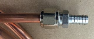

I flare those somehow. Bubble flare, half a wimpy SAE flare, Earl's beader tool, something the hose can't squeeze over. Otherwise I use common hard-line to barb adapter fittings such as this:
And yeah, I like the cunifer (copper-nickel-iron) tubing for higher pressures, corrosion resistance, and easy forming. Commonly listed for high-pressure brake lines. NOT copper plumbing tube. :oops: A much different animal. Most aluminum line is dead-soft for carb and return fuel lines, and usually rated only very low pressure, so I'd verify what you have.

Go to a hardware store and buy a 3/8" hose barb with a 3/8" compression fitting to slide over your 38" Aluminum tube and tighten the compression up. You will then have a proper hose barb for your cooler hose to connect to. You may still want to put two hose clamps over the barb area.
